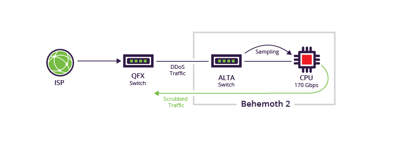

![In the new configuration, all traffic to the PoP is redirected to Behemoth 2.](/blog/wp-content/uploads/sites/9/2017/07/Behemoth-2-traffic.png)
As shown in the figure, all the traffic entering the PoP is diverted to Behemoth 2, which will then apply internal sampling for DDoS detection. It also controls the Alta switch to divert the traffic for software mitigation. Alternatively, the mitigation service can install rules on the switch to perform the packet drop in hardware.

Taking a deeper look into the appliance, we can identify the different flows for traffic traversing Behemoth 2.
- Flow A – In the case of clean traffic when the sampling function doesn’t detect any threat, traffic flows in and out of the appliance without any interruption.
- Flow B – When the sampling function detects a potential DDoS event, a divert command is written to the switch over the PCIe interface and traffic is routed to the host CPU for mitigation.
- Flow C – When the sampling function detects a potential DDoS (same as Flow B), but this time the attack is of a very significant PPS volume, instead of just identifying the pattern and sending traffic to the CPU for mitigation, the service will instruct the switch to start mitigation. The application will not offload small attacks to the switch in order to save on TCAM resources. In this situation offloaded rules will dynamically switch between the heavy hitters. This frees the application to focus on mitigating the remaining lower volume traffic (Flow B) and thereby handle a much larger capacity. The CPU will also focus on threats that require more application layer packet analysis or actions such as challenges.

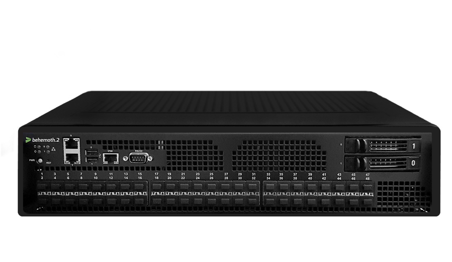

And finally, here’s what Behemoth 2 looks like in action!
